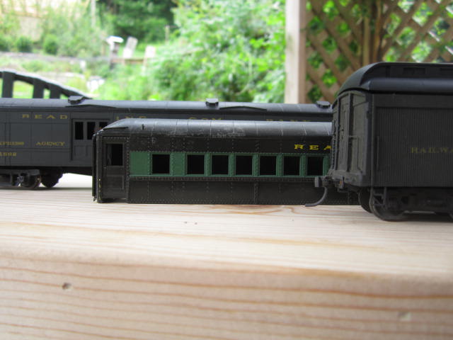

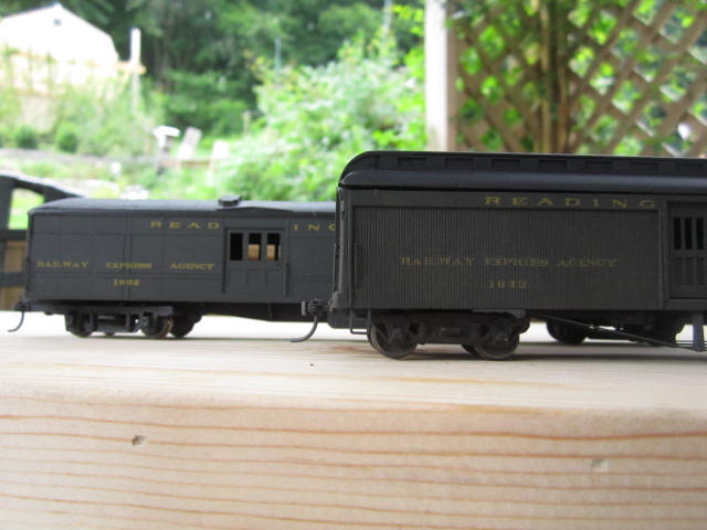

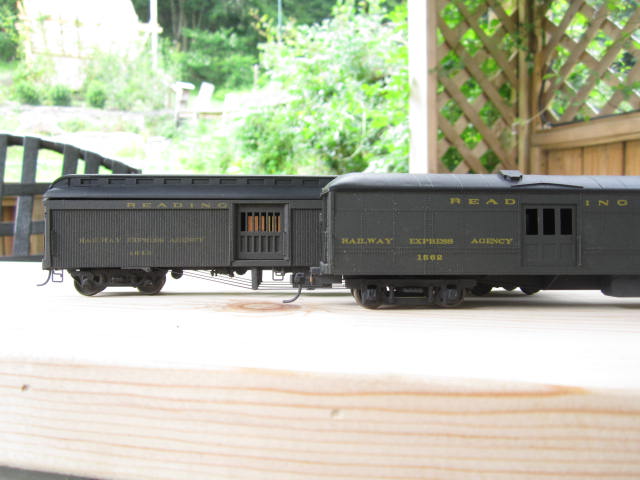

To all, some neat points have been brought up recently for starters Gary L's comment on interior, while working on another project of mine, Bee Line vol.9 no.2 Summer 1987, on the rear cover Ken Chamberlain made some field notes and in the were "inside an MU car" with color schemes and seat sketches with colors.
Next the never ending paint debate (glad this isn't PRR!!!) anyhow I am a firm believer in using lacquer thinner with Scalecoat I and II. Yes it works, but as Butch mentioned different variables will yield different shades. Also I use Testors Gloss (1161) and Dull (1160) cut with yep, lacquer. When sprayed at a higher PSI the solvent will all but dry not attacking the plastics involved. I posted a few works in progress of Scalecoat II Pullman green on wood, brass, and plastic, one paint three shades. I don't know the reasoning but the paint can be made to give this effect. The two baggage cars are flat coated with Testors 1160, while the combine is in gloss decal coat. Maybe this has some value, maybe not, any other tips out there??? Bill.

Bill,
I've used both Scalecoat I & II in the past. I used SC I to paint several brass steamers, and I've used SC II on diesels, passenger cars (solid Pullman green), as well as freight cars. I've always used SC thinners, but it's good to know that plain old lacquer thinner will work in a pinch.
Thanks for the rolling stock photos. What are the colors you used on the two tone coach? It looks good, whatever you used!
