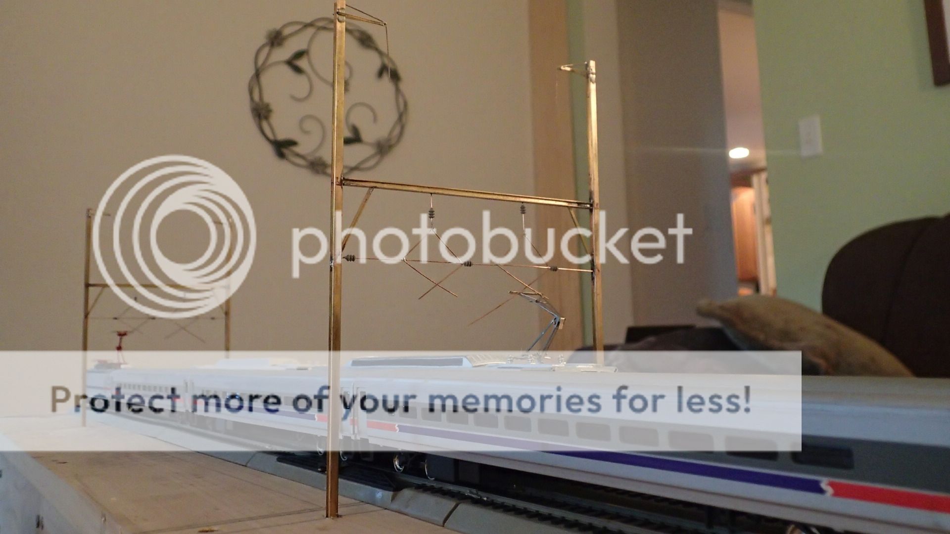

I have already begun building an mock-up (which is probably good enough to be used on my layout).
Have a look!
I used "H5" 5/16" H columns for the poles, "H4" 1/4" H column for the cross beam, and I can't remember which stock the "T" brass came from, but its used in the corner sag braces. I have 0.025" Phosphor Bronze wire for the wires. I also have a jig that cuts 0.020 brass wire into grab irons that fit the H5 columns, And i will add those in as well!
The extra length on the bottom lets me mount the poles beneath the layout, and adjust wire height.

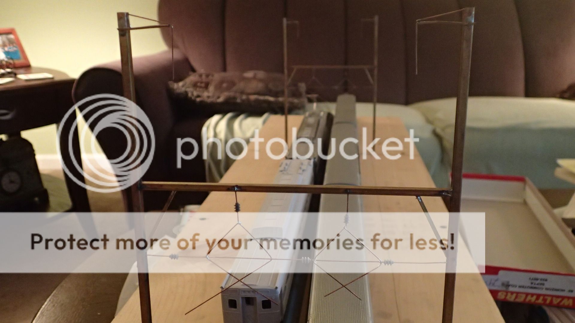

Well, Here is what I have. You'll have to forgive the SEPTA until I can get my green cars together.

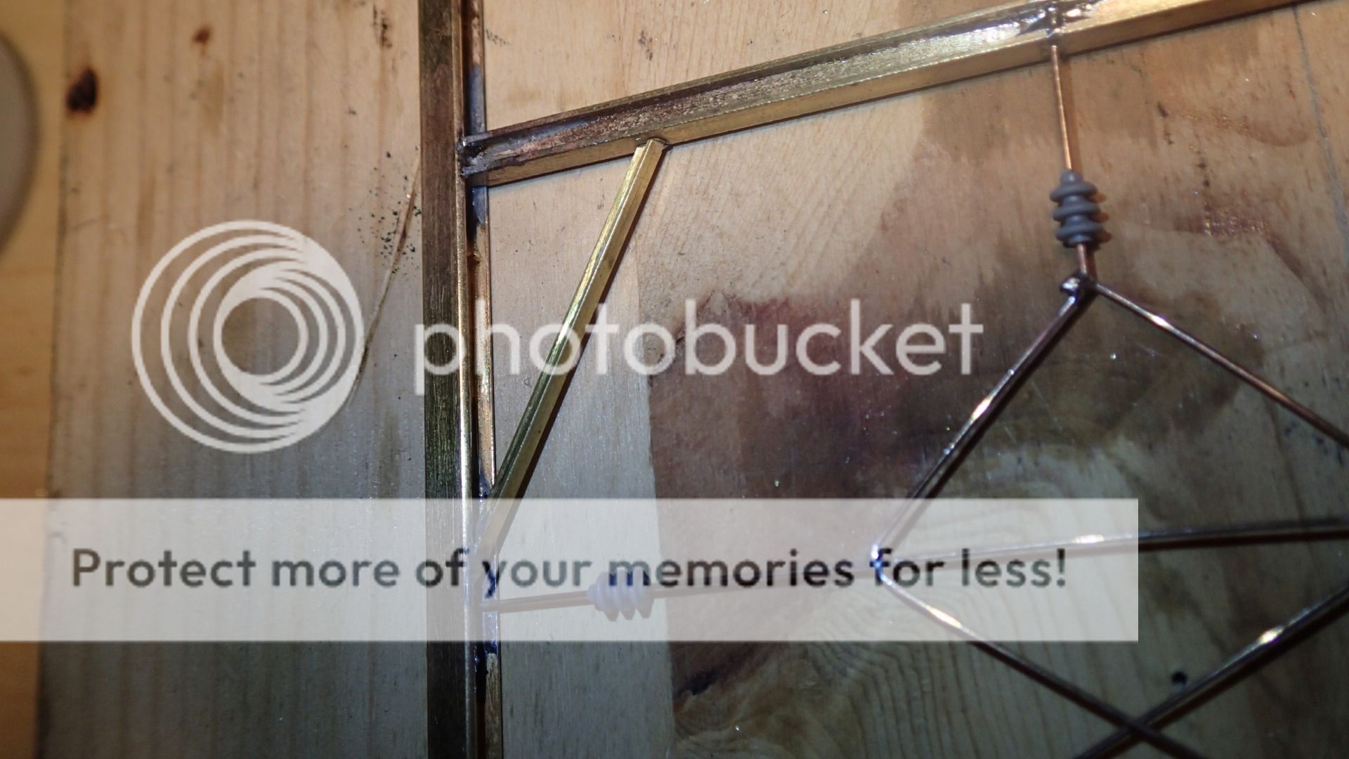

I think the distance between the steady span and the cross beam is to far, and that the structure should be lower. This can be done (by unsoldering the wires and cutting back the corner braces), but i'm going to wait until I get some real dimensions, just in case.
I have not yet made the wire, since I am unsure if the poles will stay this way. At this stage, creating the catenary wire and hanging it is VERY easy, so if I don't decide to rebuild these, I can wire this up in an afternoon.
The excess material is so that I have some extra to solder the wires to. Once I have the contact and auxiliary wire about 2' from the cross span and centered, i'll solder both to the steady rods to the auxiliary and snip off the excess
I used one long wire to make the hanger and half the steady rod, and used a second piece of wire for the other half of the steady rod assemblies. The insulators are by Tichy
