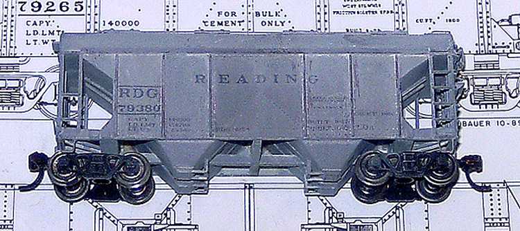

To continue, Mitch mentioned plans for these LO class covered hoppers. In the June 1989 issue of RMC, George Losse did a write up on these even with a photo of one in Conrail as a scale test car. As far as a resin kit, doubt Funaro will ever do it, I played with the idea of a modified Tyco covered hopper roof, making a pattern of the sides then casting them, and using an Eastern Car Works / EB Valley covered hopper as a "core". The dimensions were very close overall most notably it was a little over a scale foot too long. I never went farther than the drawing board as other projects held my interest.
Ground Coal Loading Only Covered Hoppers 12 years 9 months ago #2255
Here's a pic of one that used the Tyco car.. I gutted the body to fit the E&B slope sheet/hopper bay casting. Ends and side ladders/sills were also form the E&B kit, as was the centersill, shortened. New hatches were added, new brakewheel and platform, and a riveted styrene overlay for the center panel on the sides. Also added the angled fillet along the top of the "chord" between the ribbed and non-ribbed portion of the sides. Had to shorten the roof by a foot or so also, to match the plans.
