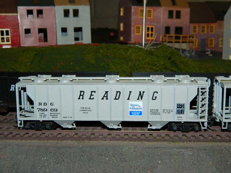

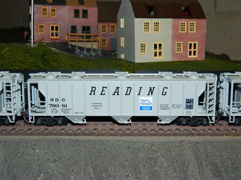

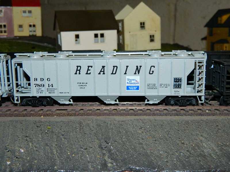

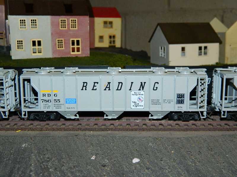

Athearn HO PS 2893 3-bay covered hopper 12 years 3 months ago #3066
As noted they aren't perfect, but they were a fund raiser and in their day were pretty much the only thing out there, here is four out of five. (number five is still AWOL after digging through boxes for 2 1/2 hours)The last car in the series has the same poster as 78655, I believe)
