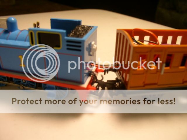

For the Thomas sounds I used a soundtrax decoder for a small switcher type loco. It sounds good enough and if you only press #3 and get the short whistle blast, it kinda sounds like the english type that Thomas uses.
As for that install... as mentioned not too hard at all. The cab roof of Thomas comes off and there are only a couple of wires. There was a small circuit with resisters, but I couldn't see that they did anything (there is no working headlight) so I cut it out and extended the motor wires into the first coach by drilling a hole in teh back of the cab and front of the coach. Next, had to remove the weight and cut a hole in the floor of the coach for the speaker. The coach roof lifts off for access. I'll post a picture or two in a few days.

Here's those inside photos of Thomas and the sound install.
