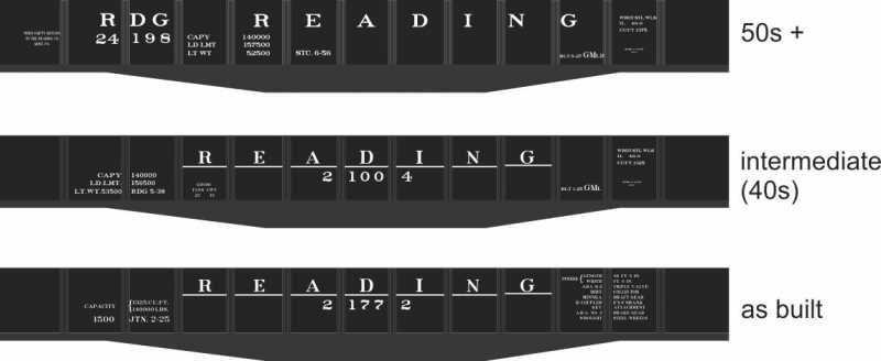

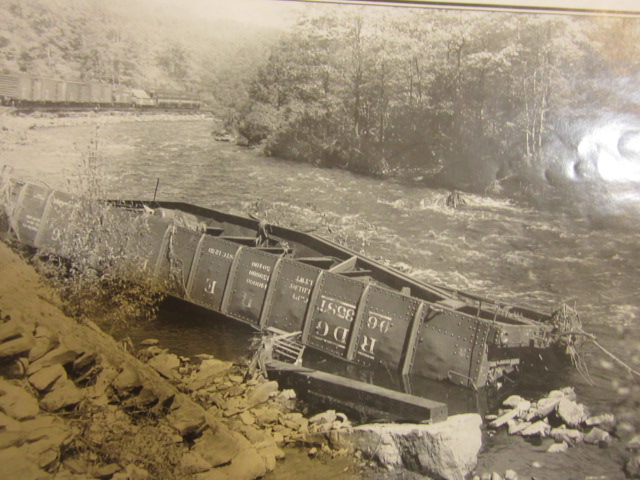

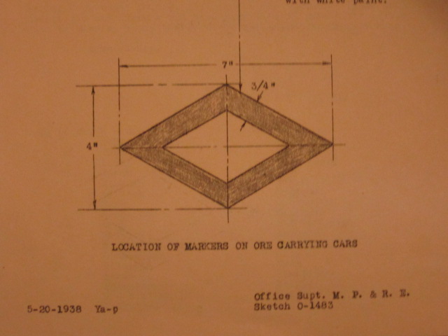

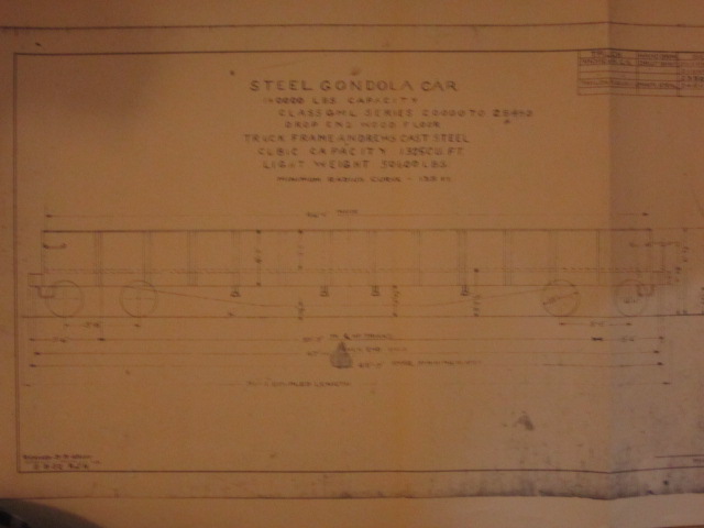

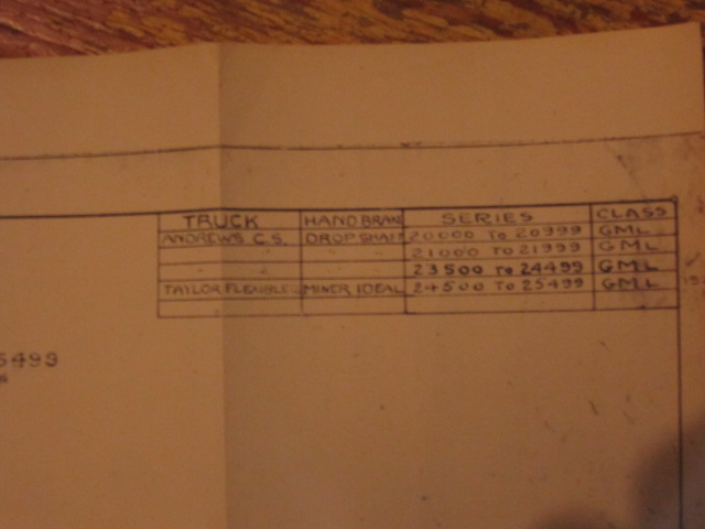

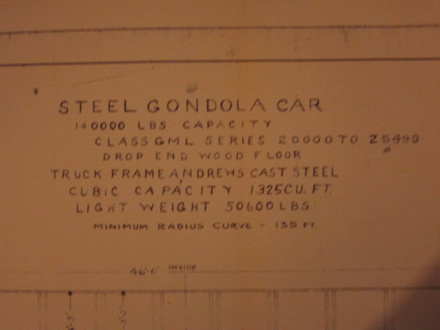

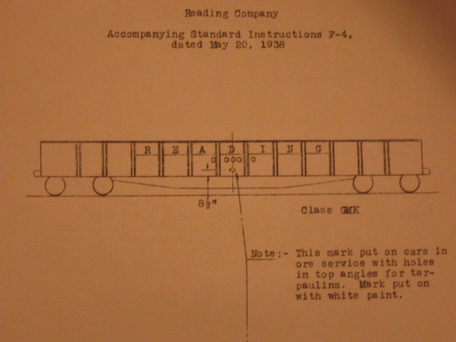

Evan, that looks like it would be a GMl. If memory serves these were USRA "clones" as there built in the 1920's. As for decorating we modelers are lucky as Jerry Glow does 3 decals sets for these, pic 1. I also posted a print of these with some useful data, revised 9/49, and even a detail print of this class's twin the GMk for those modified to carry chrome ore. There are a few other posts buried in the forum here on these gons as Walthers did a few runs. Lastly, here is one dumped in the Schuylkill after hurricane Diane numbered in MOW service, note the brake detail which differed from RTR models, Bill.

"LNE BILL", Viola! That is it; the drawing with the revision notices showing the car numbers is the cat's meow. Still looking through the Bee Lines for the photo of this car with the underlined road name. Assumed the Walthers offering was a generic car labeled for whatever road name would sell. The view of the overturned car is a nice find.
Thanks again, appreciate your effort.
