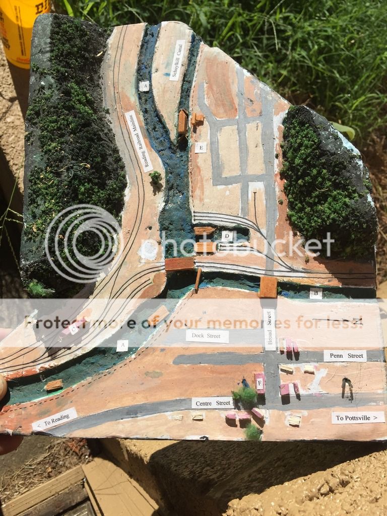

Port Clinton circa 1875:
Track Plans 10 years 3 days ago #5514
What is the foot print size in your finished scale?
Track Plans 10 years 2 days ago #5515
In HO I guess a rough estimate would be about 25' square. This was a diorama I did with our son about 8 years ago.

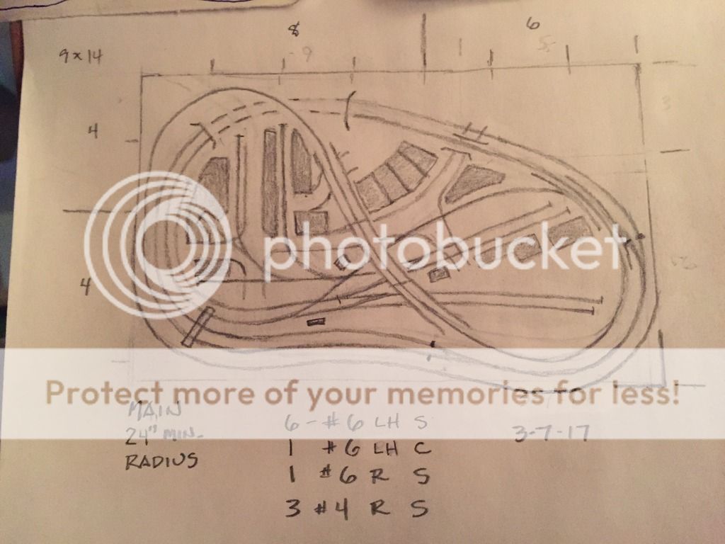

A good part of the hobby for me is track planning. When I was 12, I went on my first visit to a "professional" basement layout in a suburb of Philadelphia Pa. Regretfully I didn't get any pics, but the memories are still vivid. It was a typical "spaghetti bowl" plan of the era. While trying to recall the basic idea of the plan, I drew this HO scale plan up the other day. I know The actual layout had a good bit of hidden trackage and was fairly complex. I try to avoid hidden track in general. So, this is a rough take on what I can remember. Basically a folded figure 8. I like how the yard came out as a self contained switching area, and the main is kept simple. Of course staging would be desirable, as well as some crossovers, but I didn't want to get into any reverse loops. Plus the number of turnouts is kept low. Anyway, the overall size is 9'x14', and I wish I had time to build it!
