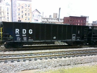

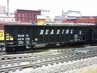

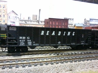

Many posts ago, possibly on the old web forum. I displayed my displeasure in the way the companies painted car choices. My major repaint program Is taking my
1.)old bowser cars factory painted HTg with the large RDG. I sprayed out the herald, data, number. I left the Bethlehem Steel logo. and then decaled it to a HTe with reading speed lettering. The car is right for a HTe but the slope sheet is the wrong angle for a HTg.
2.)Bachman silver series cars factory painted in Reading HTe with Speed lettering. It has the right slope sheet for a HTg so I am removing and painting out the speed lettering and number & data. Again leaving the Beth Steel logo. Then decaling it to a HTg with the large RDG and new data & number.
Both these companies seemed to think they could sell there version yet both were wrong and could have been right. go figur?
3.)The third and cheapest cars are the Life Like cars. some were Bev bel. I picked some up at a swap meet for $5.00 ea. The paint was right well almost. with the Beth steel logo missing and the white R inside a yellow circle makes it closer to an HTd but the R should be in the next pannel. These cars need frame work. I shaved down the bolster and shoved out the trucks tword the end and put KDs in coupler boxes. Like the article in RMC. Neubaur sounds right. bracing the coupler box is the hardest part.
The last photo Is a repainted and decaled and modified life Like HTe.
Daniel J Mohr
