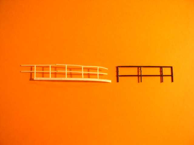

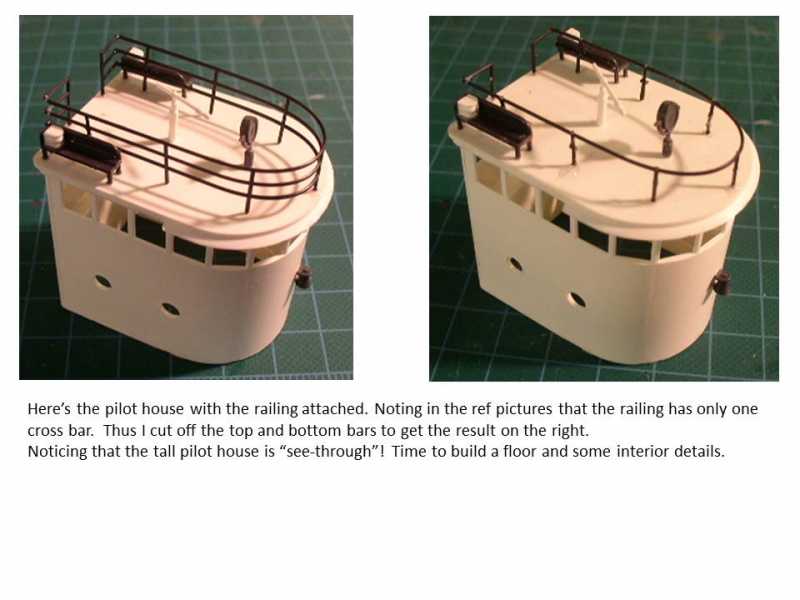

Hey Aaron... Well... I would normally agree with you ...
here's a picture of what the railings might look like if "cropped"....
3still not sure which way to go....
Last Edit: 13 years 2 months ago by rdg-barry.

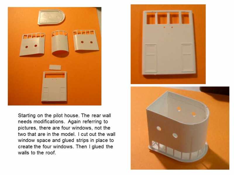

Reading Co Tug - Schuylkill 13 years 2 months ago #1733

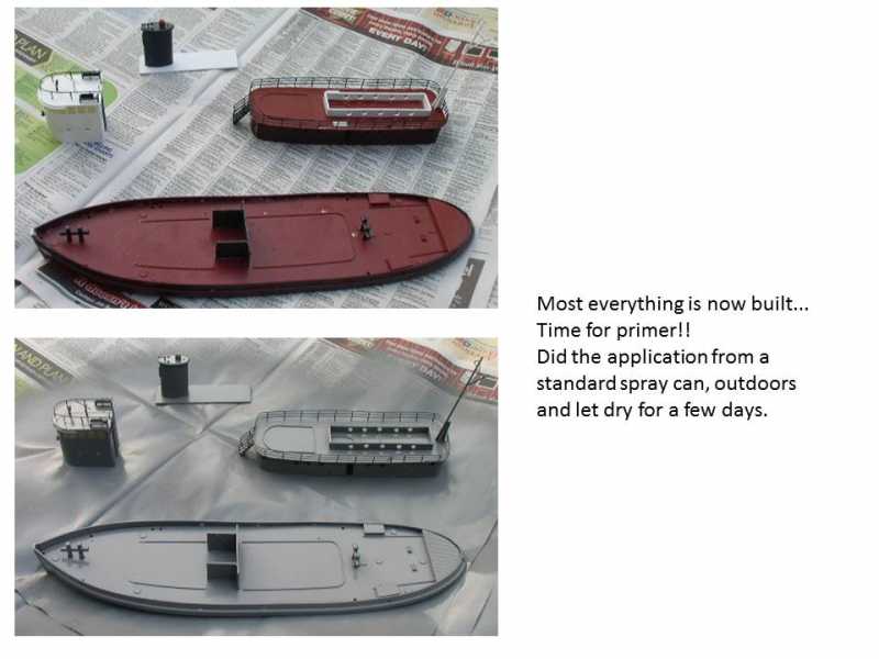

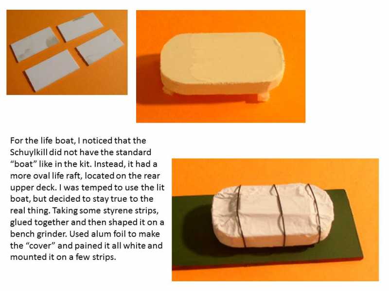

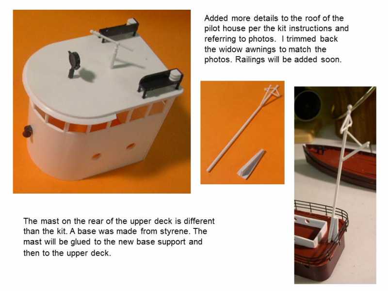

Also... here's the next set of build slides....
time to work on the pilot house!

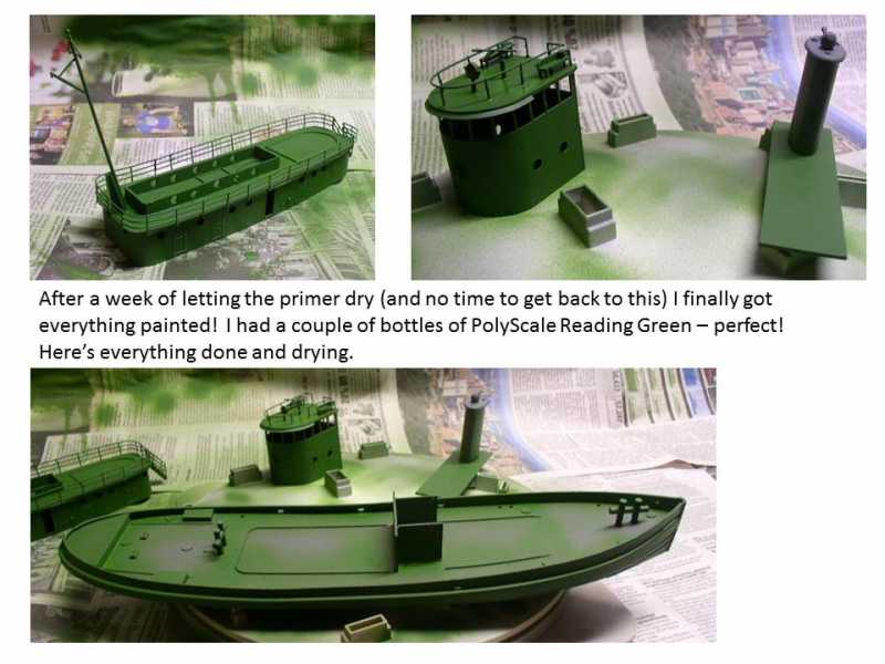

HELLO... time for more progress....
Haven't heard from anyone on the color questions I had... if you could chime in soon please, as painting has started! Here's the next few slides of the build...

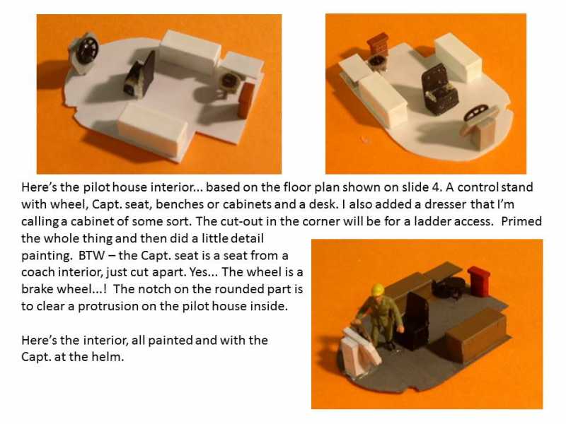

Reading Co Tug - Schuylkill 13 years 1 month ago #1795

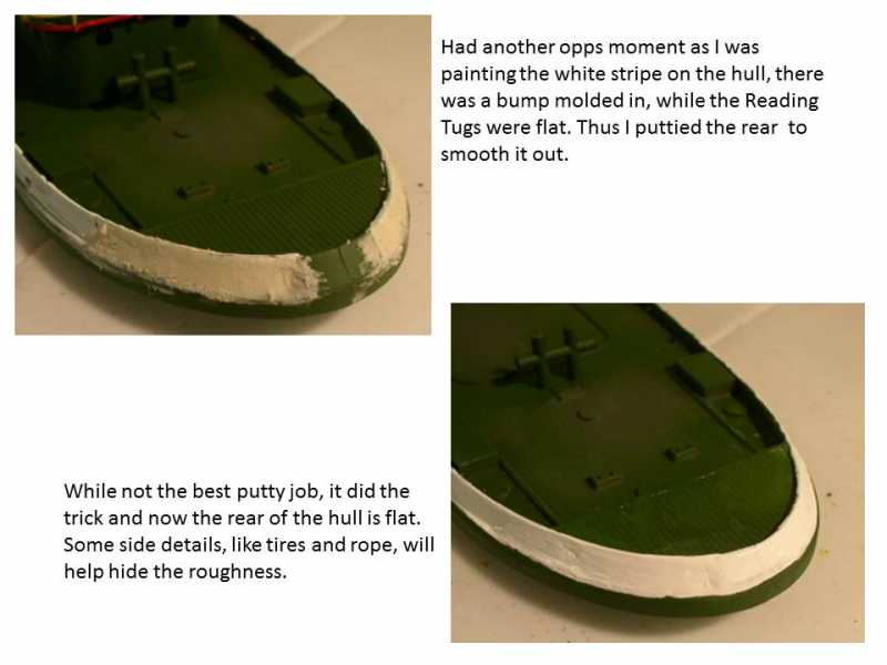

Here's some more of the weekend progress... it's finishing faster than I thought!
