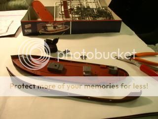

Here’s some of the basic kit components… these are the hull parts, which is built first.
The right side of the hull gets glued to the bottom after some supports are glued in. The bottom edge between the hull and bottom does not have tabs so be careful when aligning these parts. I used some ACC to hold them together more quickly.
One would think you glue the left hull to this assembly – NO!! the deck must now be glued to the right side and bottom. This is because the hull sides are wrapped over the decking and you would never get the deck installed if the hull was glued together. BE VERY careful lining up the deck with the hull side!! (don’t ask me how I know…)

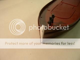

The deck is curved so some weights were added to help hold it down while the glue dried. My mistake was not being careful when aligning the desk and it was too far forward – See how I did not get the front lined-up properly!

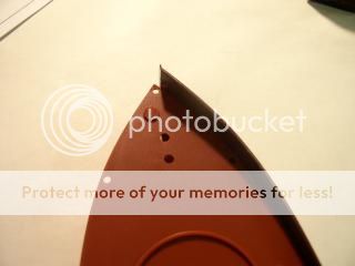

Gluing the left side hull on I again used ACC to tack it in place, as you have to line it up and there are no good tabs to do that. Now when you try to glue the left side hull on, you end up with a gap at the front -

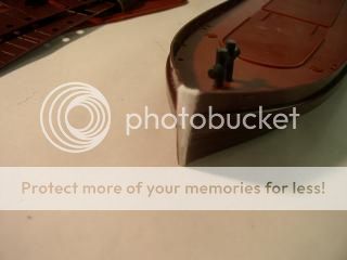

One possible solution would have been to trim the deck to a new point to match the right side hull piece. But I figured that tug boats would not need a sharp hull point, plus when you add the fender (the large mass at the front of a tug that it uses to push with) it would help hide my mistake. I proceeded to fill the gap with some strip styrene and putty -
Again, it doesn’t look too bad and most will be covered anyway.
