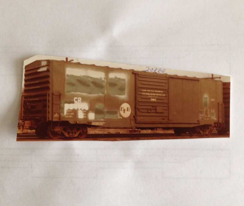

Here is a photo of mine of CR 231776, ex RDG 20180, I think I am going to do my Accurail car as this slap over.
