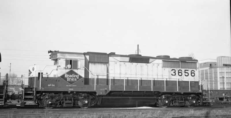

I see Walther's is adding the GP35 to their P2k line.The unit is based on PH II production which,to me,is great news.No RDG units in the first run but they do have undecorated models listed,release date listed at the end of May 2016.
Looking at the art work on Walther's web site and comparing it to prototype pictures of the units offered match up well.However,the model doesn't match up to the RDG's 3626/55 units.The main spotting
difference is the number of door latches on the long hood and number of vents on the battery boxes.Like the RS3 many variants on the 35.I'm guessing RDG's 3626/55 were considered PH 1b units.
Anyway,I'll still plan on some undecorated models to go with my P2K 30's

Chris - Do you have a link to this Walters announcement. I scoured their site and can't find anything. FYI, Phase 2 may work for 3656.
Items of Interest 10 years 7 months ago #5067
Bill... On their site hit the train button,a box will show up.Scroll down and hit diesel,on the next page refine the list to GP35 and tap on that,it will put you on the page.
Items of Interest 10 years 7 months ago #5070
The Reading GP-35's were Phase 1A and 1B units, with the exception of 3656. That was a Phase 2 unit. All that would be needed is to replace the 36-inch fan with a GP-7 style fan.
