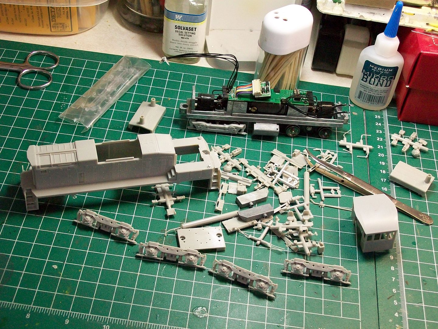

First I removed the body from the frame.The dreaded micro bulbs were glued in place,I was able to free them without causing any damage.We then had an explosion of parts.

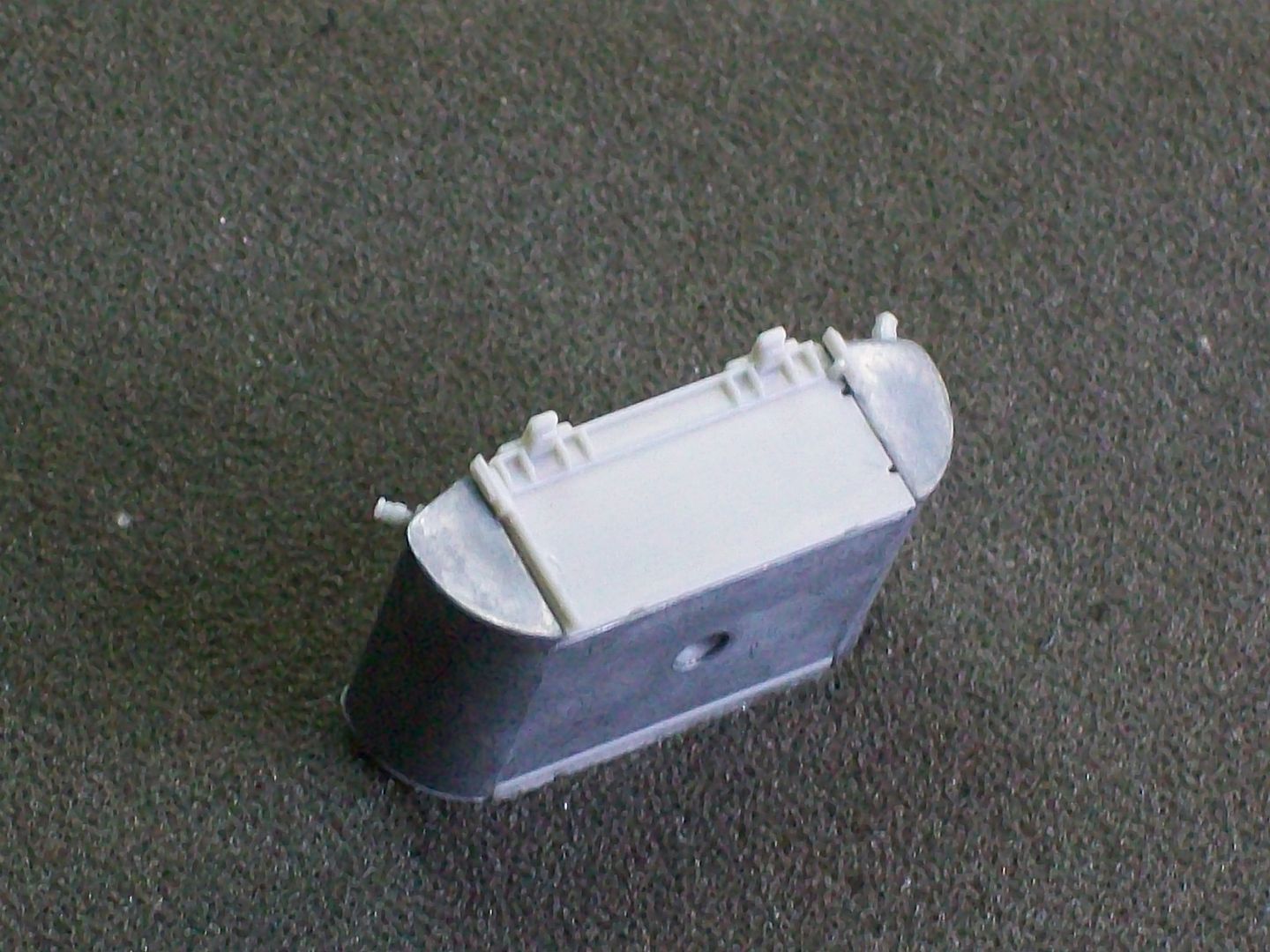

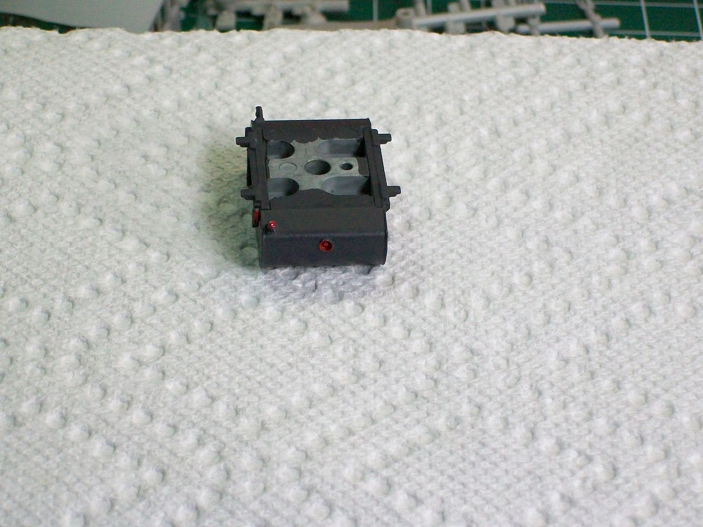

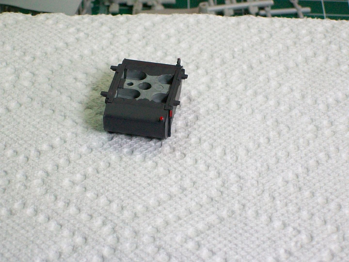

As with the C424 I'll be starting from the ground up.I removed the fuel tank from the frame.It's held on by one screw.I then added the end walls,caps and sight glasses.The tank itself is metal and the add on parts are styrene so I secured them with my combination of Walther's Goo and MS microbond.
The rear facing portion of the tank.

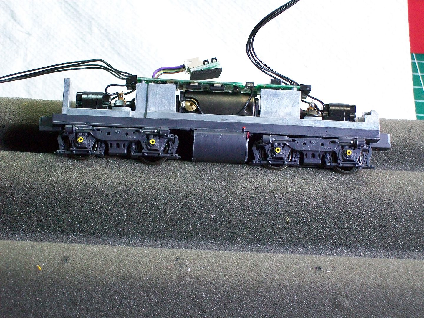

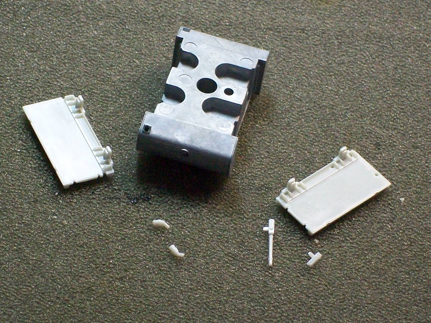

Next came the trucks.The unit came with both styles and of course we'll be using the Flexicoil side frames.In removing the other side frames every single mounting pin sheared off so I had to take off the bottom plate and remove the wheels so I could remove the broken pin.Frustrating,but it turned out to be a blessing.The gears were packed with grease so I cleaned the excess at this time.Anyway,I added the cylinders and speed recorder cable.
Next I hand painted the trucks and fuel tank with Floquil's weathered black.I also painted the lower area of the metal frame.
Fuel tank
After the paint dried I mounted the fuel tank and trucks to the frame.

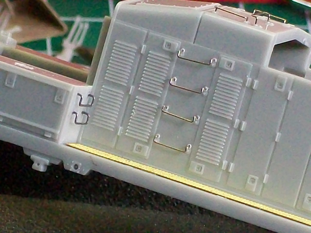

Continuing...I decided to work the cab first.I used my BLMA grab iron template and marked the area below the engineer's front window for the addition of the grab iron.I drilled two #80 holes and mounted the grab,Cal=Scale #190-531.

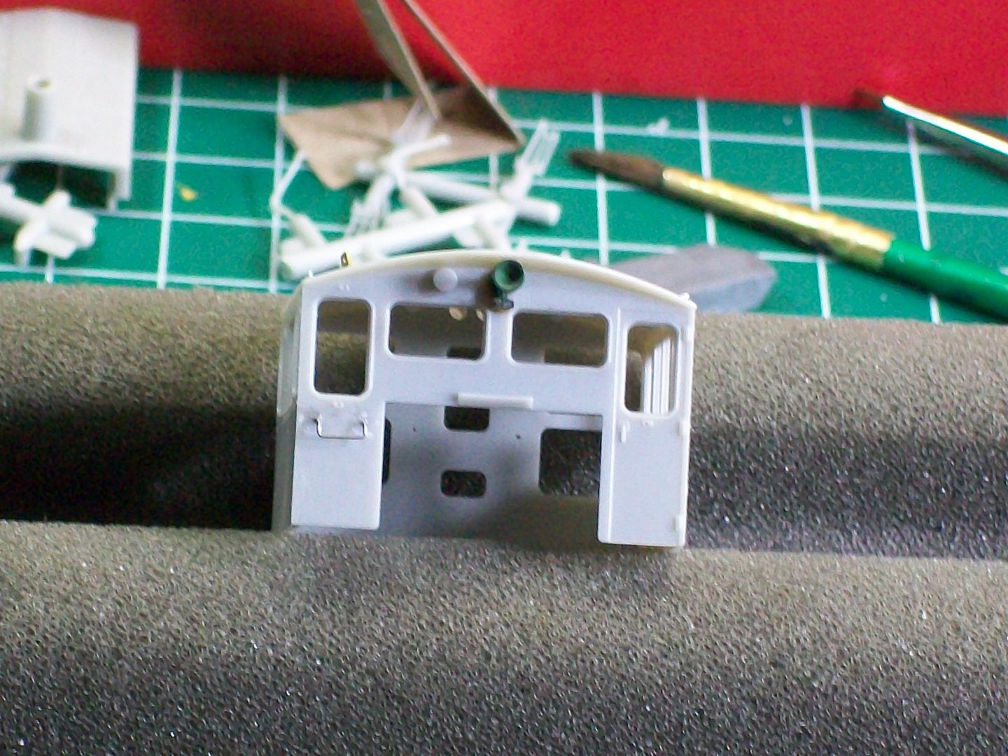

Next the horn...luck would have it,no horn included with the model.I tried the cal-scale brackets and a detail west single chime horn,but because of the size of those castings I couldn't get them to fit below the roof line.Checking my parts inventory I came across a horn from an Atlas GP7.These were mounted on the sides of the Atlas unit.I cut off the mounting pin and then glued the horn directly to the cab wall using Walther's Goo and micro-bond.
Here are two views of the horn and grab.

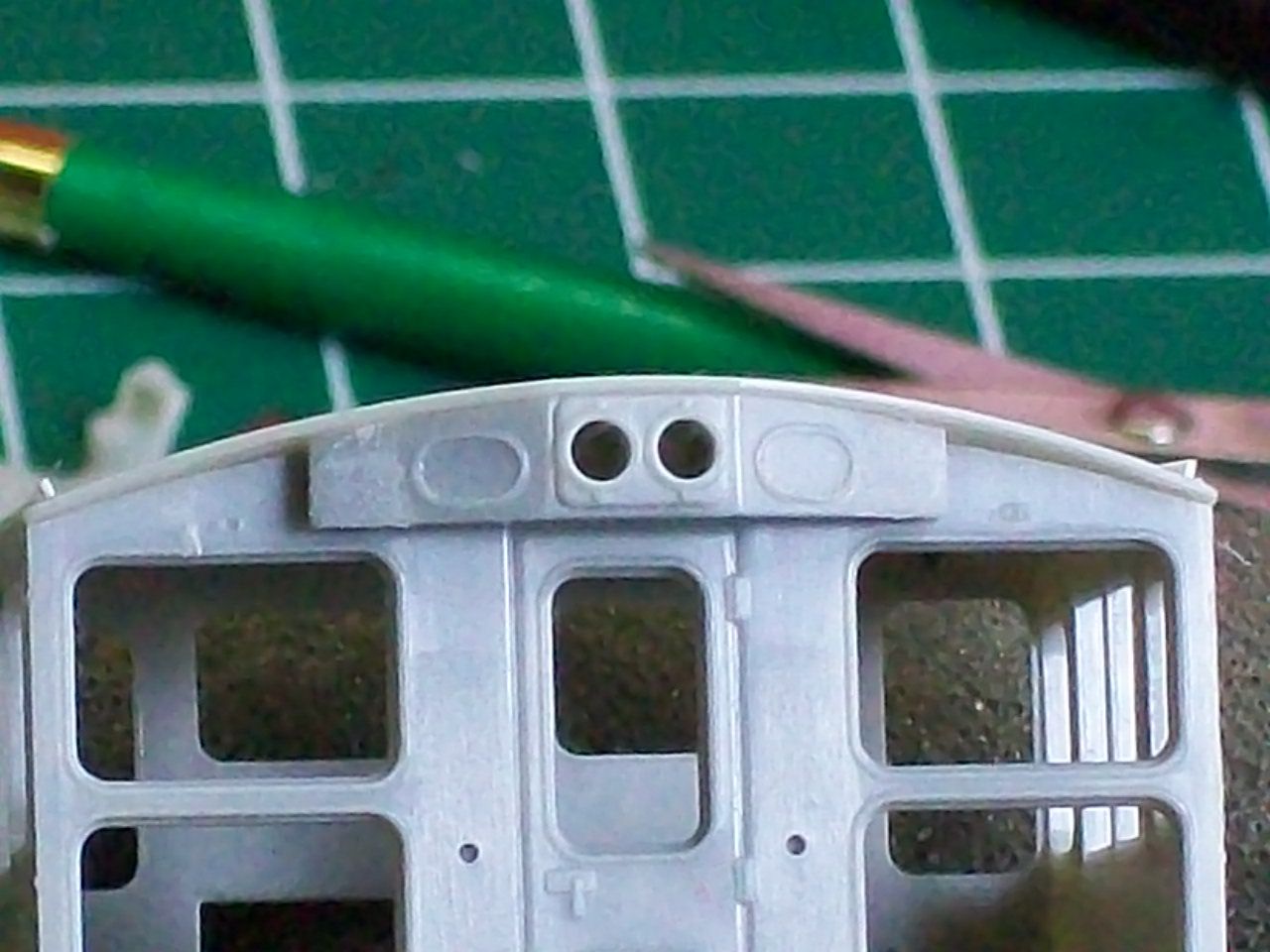

The RDG units did not have marker lights.Using a straight razor I carefully removed and then sanded.

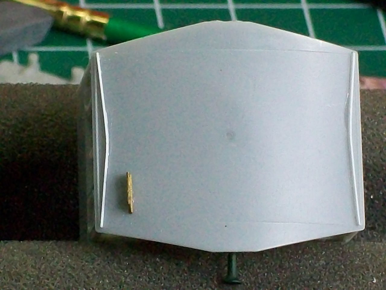

Next I worked on the drip strips.I used the same styrene strips as described in my C424 build.When measured I needed each strip to be 29/32 so my "V" bend was made at the half way point 14.5/32nds.I mounted them using Testor's model glue.I also drilled and mounted the antenna.The antenna came from my parts drawer and I believe its a cal-scale part.
Here's a view

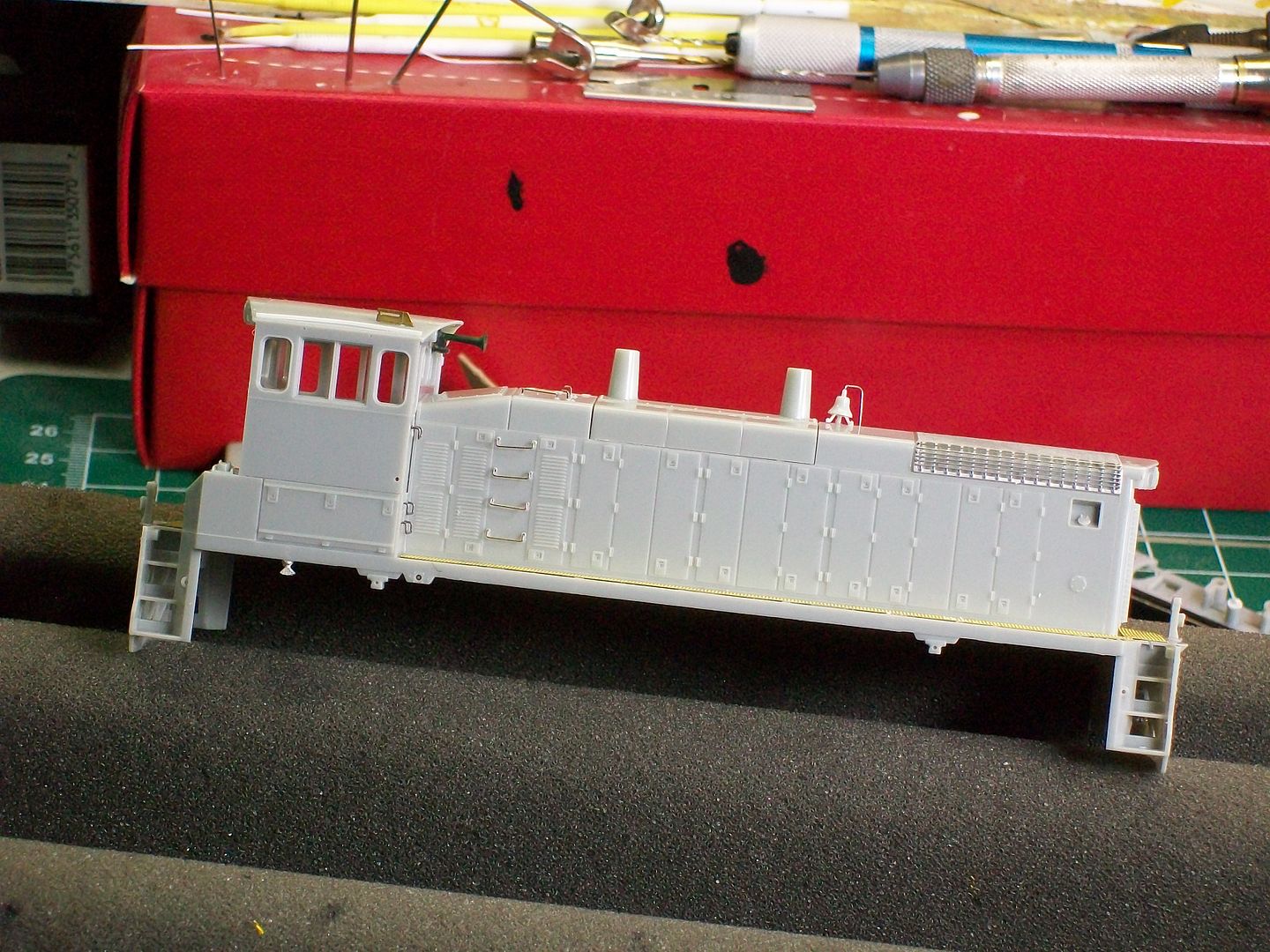

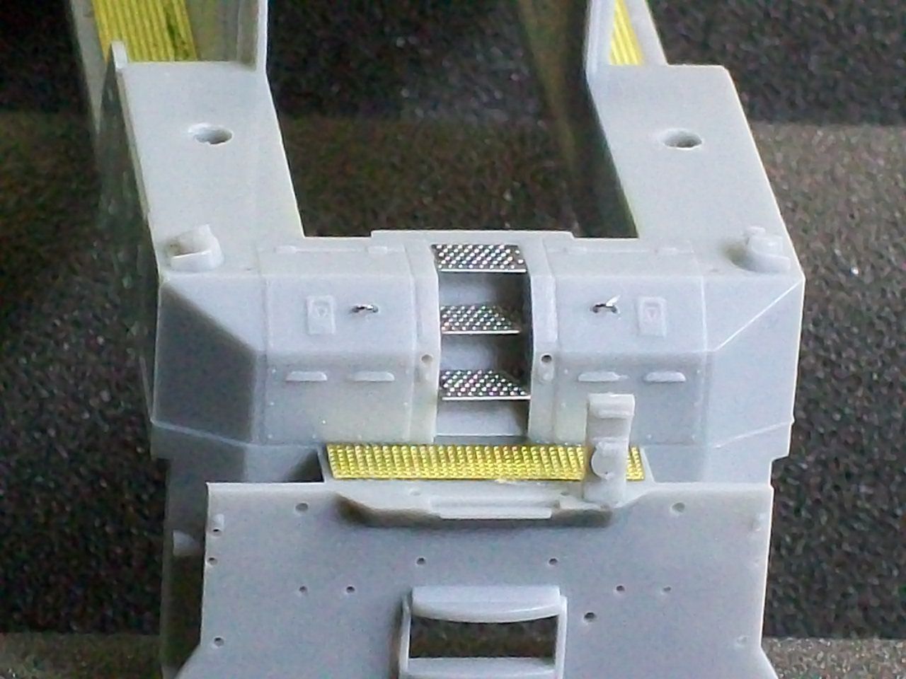

The body...I chose at this time not to add the air tanks and piping under the walkways till after painting so they wouldn't become damaged from handling.I did add the sand hatch lids and assembled the mu hook up and mounted it to the body.I used my template to make my marks for the mounting of the two lower grabs below the right front window. Note;a very difficult area to drill because of clearance issues with the pin vice.I started with a #80 and opened it up a little more with a #78.I added the same grabs as mentioned above and I also added the Athearn grabs.
Again,I removed the front marker lights as described above.

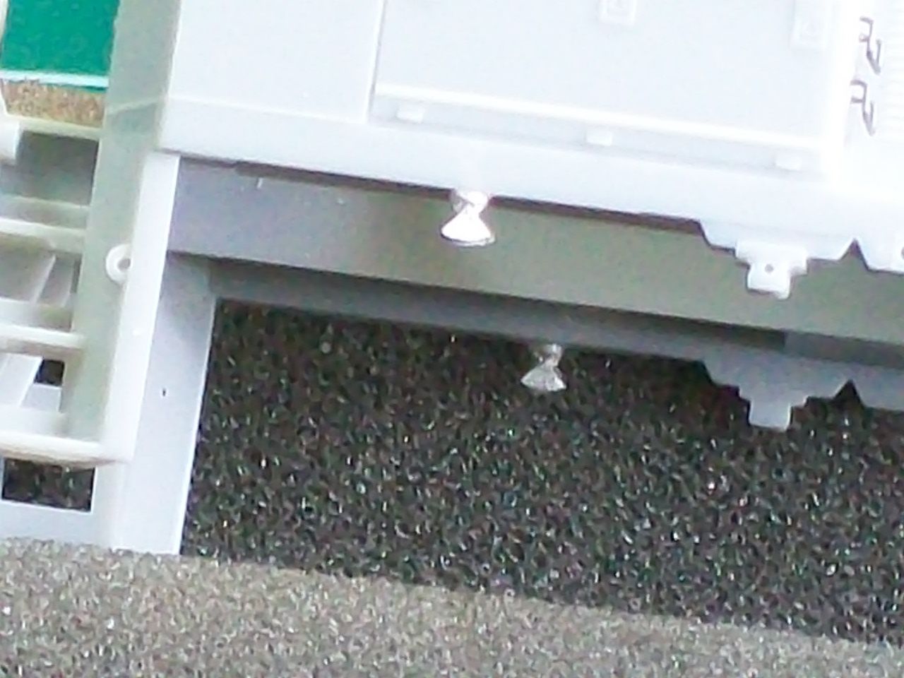

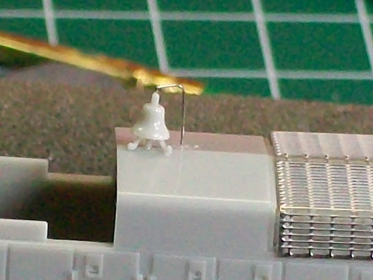

Next,I assembled the bell and mounted it to the body.I test fitted the metal wire to fined my mark and used a #80 to drill the mounting hole.I secured the wire to the body and bell using CA.

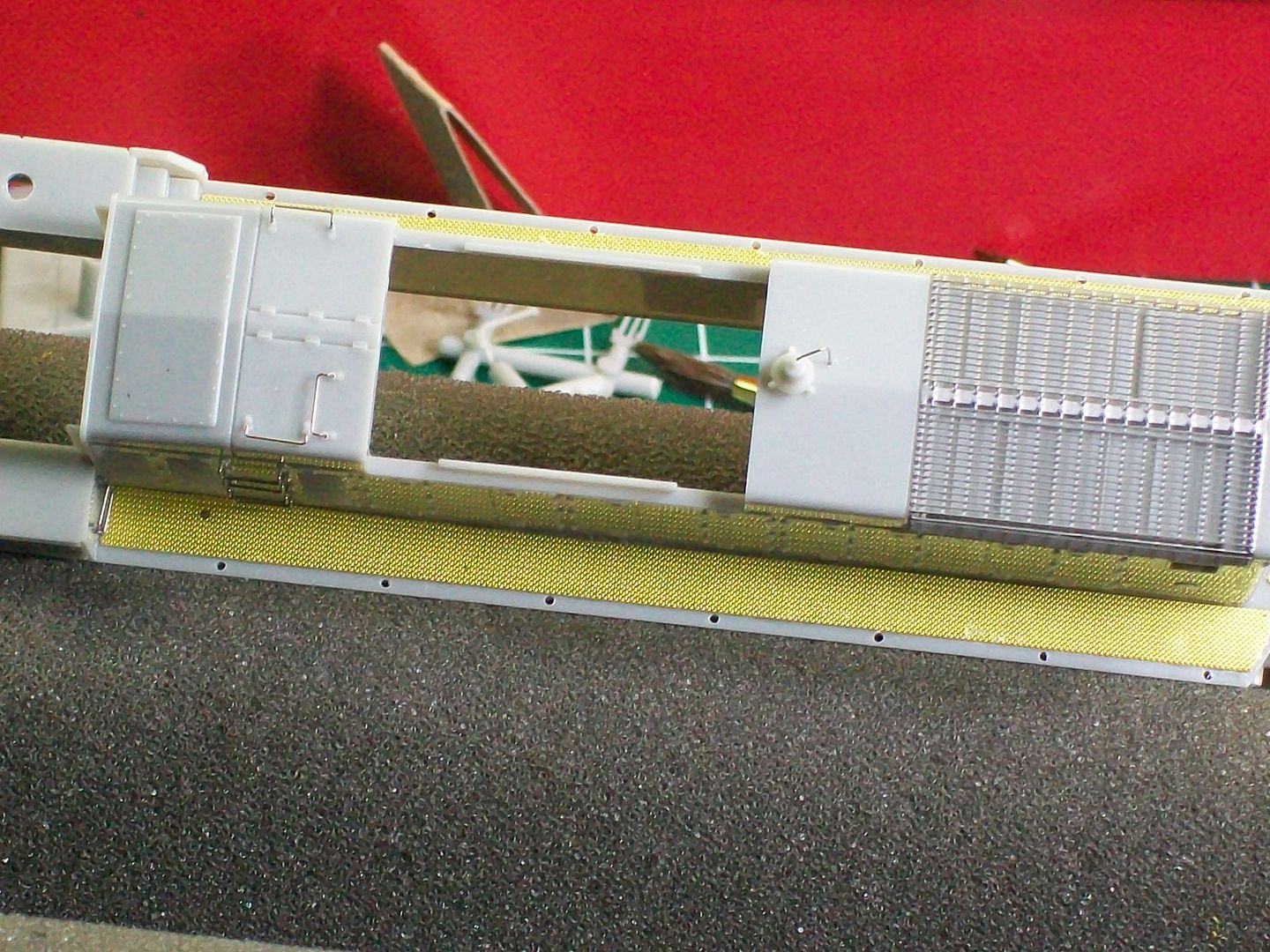

I drilled my holes for the standchions next.After drilling I added the Cannon tread plating.Now,Cannon makes a specific kit for the SW1500 I had some left over stuff that I cut to fit.I sanded the undersides of each piece and secured them with CA.
I also added the steps that came with the model at this time.
I also added details west,#sl-172,step/inspection lights to the underside of the frame below the cab windows.
A look at the units right side.

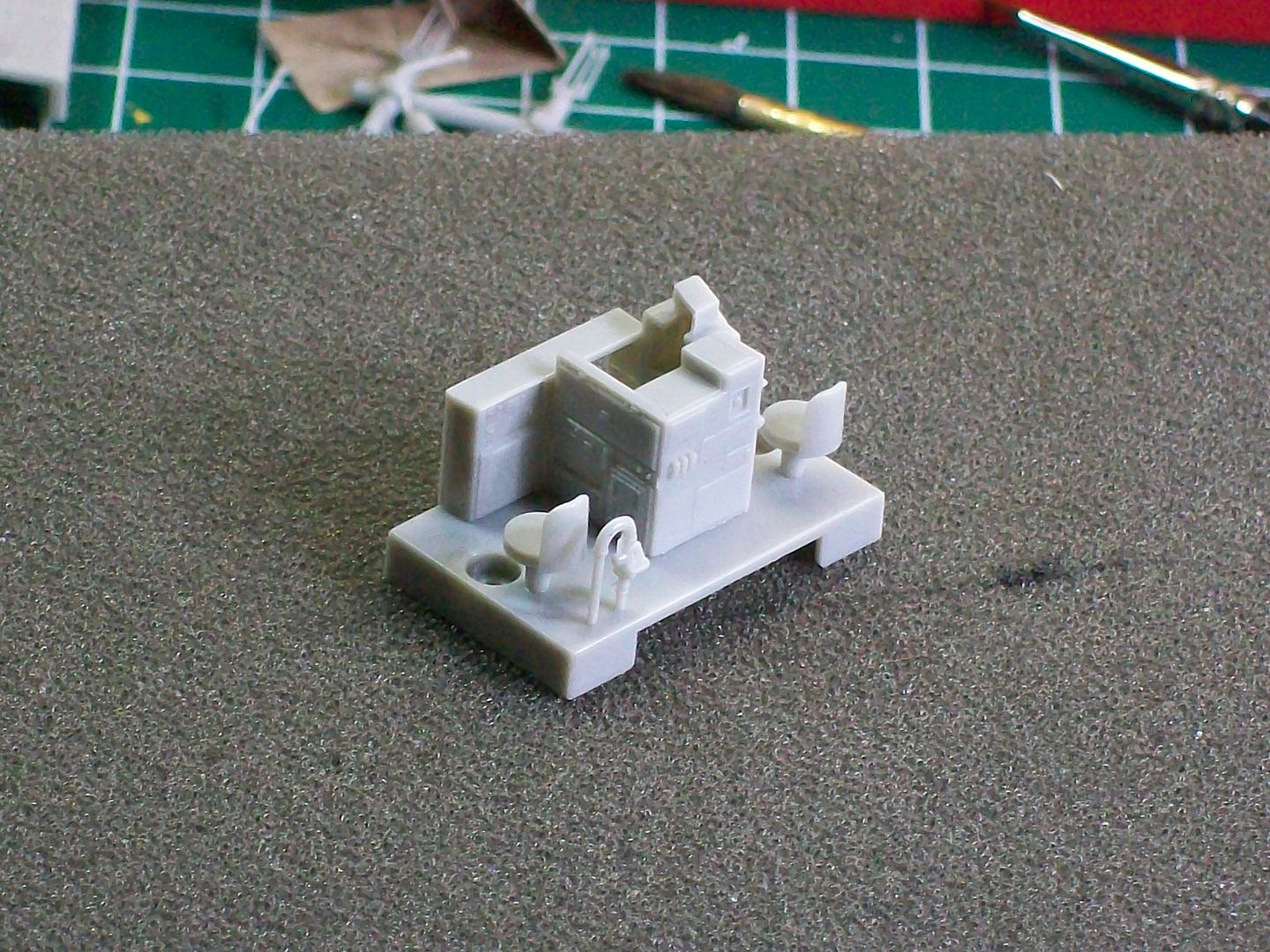

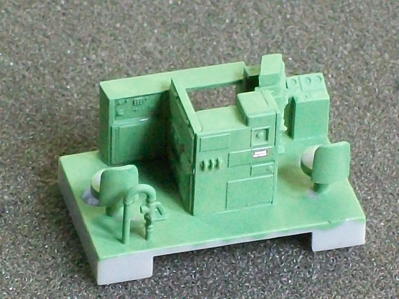

Next...I assembled the cab interior.
I then painted it using Testor's Model Master Pale Green and after it dried I added the Danger 600 Volts decal.

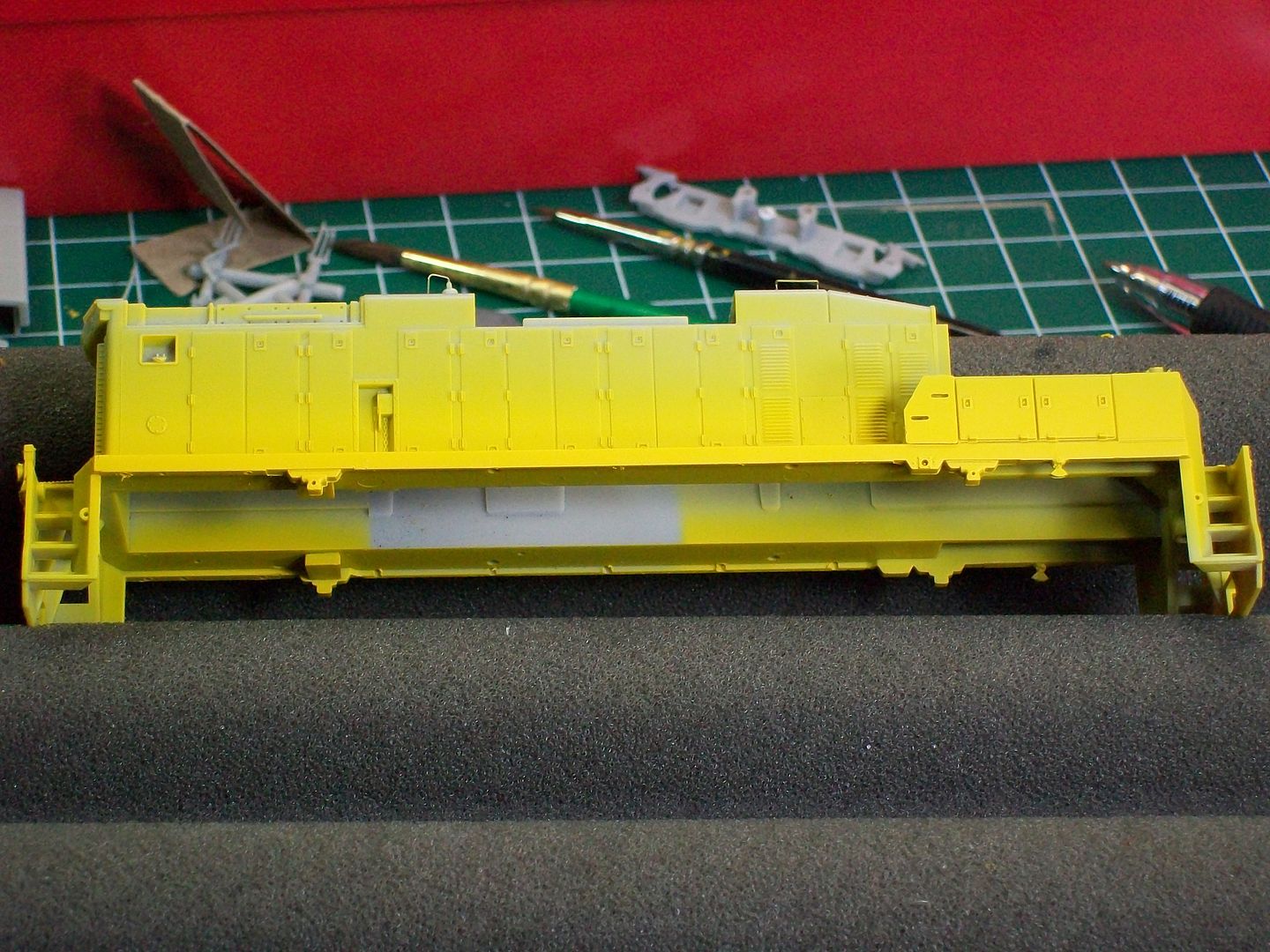

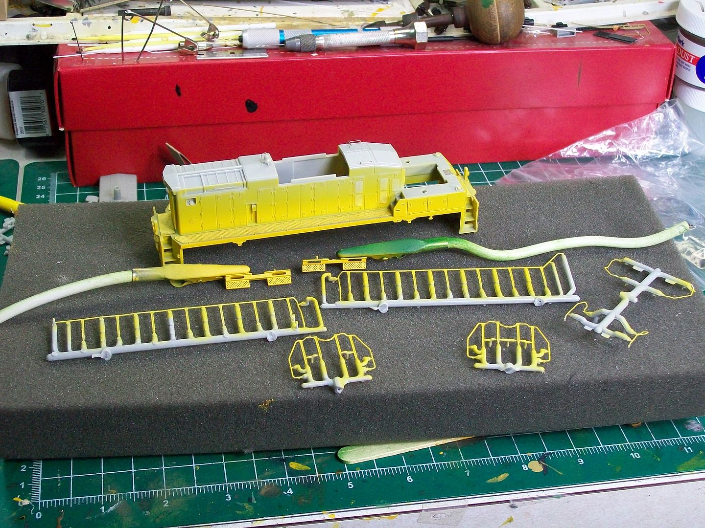

Added the yellow to the unit this A.M.I used Floquil reefer yellow applied at 12 to 15 psi.I did not prime paint the unit.I applied the paint to the side frames, pilots, pilot steps and hand railings.I wasen't too concerned with covering the hanrails completely because I'll touch them up with a brush after they're mounted.

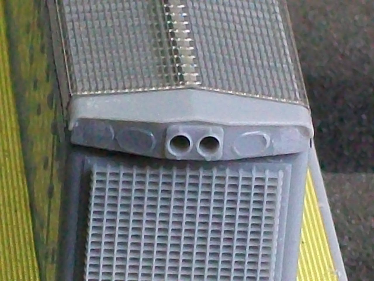

The following pic shows one of the pilots and because of the available decals this needs a little explanation.Microscale's RDG barricade stripes are yellow.They would have made things easier if they made the yellow area of the decal clear and the clear area black.So except for the framing around the coupler pocket I will be hand painting the entire pilot black.
Now,if you think you can overcome this by using Herald King decals forget it.Their pilot striping is completety wrong as is Athearn's application on their 2763 unit.
