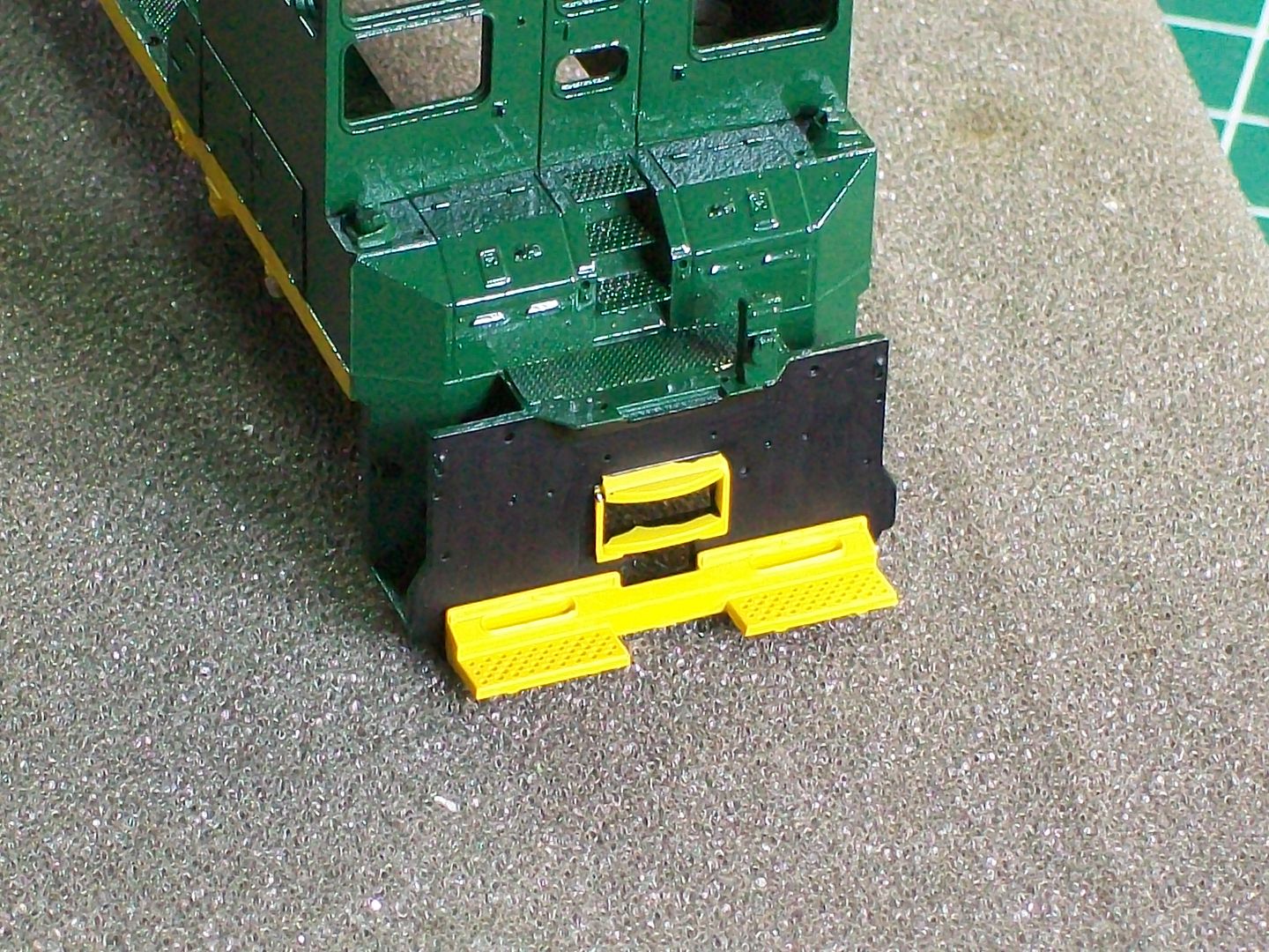

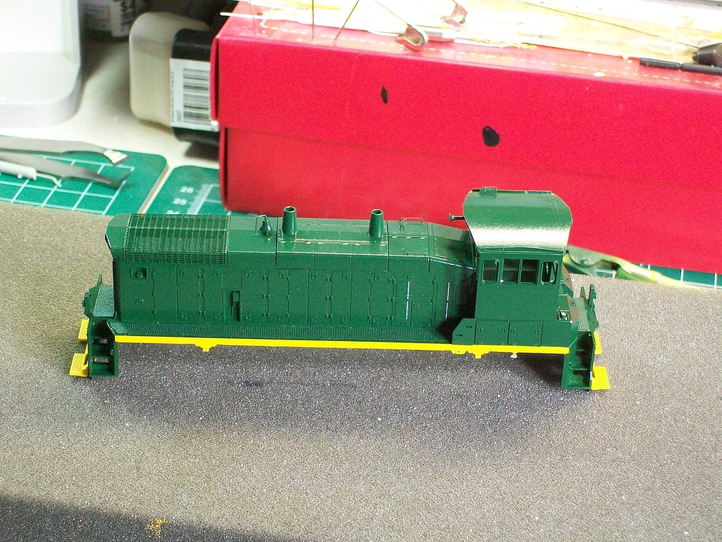

I applied the green paint last night and hand painted the pilots black this morning.I used SCII southern green and Floquil engine black.
As I described earlier the pilots needed to be black because of the decal and the framing around the coupler pocket and the steps need to be yellow.Here's the results your looking for.
